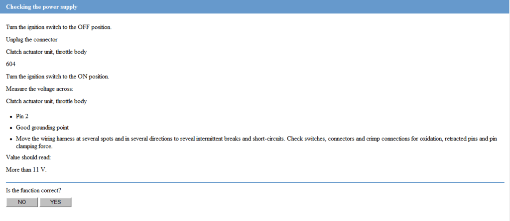

If the problem suddenly happened then it must be something to do with the actuation.
If the solenoid is out of phase then maybe the TB is set fully openwhen it should be closed.
As to the spring it may work just the same in either direction if a force is applied.

Switch off ignition,remove key and restart overcomes the problem.
No codes and opcom shows 126km since last regen 46% saturation etc so nothing to do with regens and oil level good.
My feeling is that it probably has something to do with the throttle pedal actuation/switrches although I dont know how it all works at the moment.
I am going to actiavte the pedal a few times before starting and see how we go from there.
If it keeps doing it then WIS beckons....and Ebay for spare bits!
