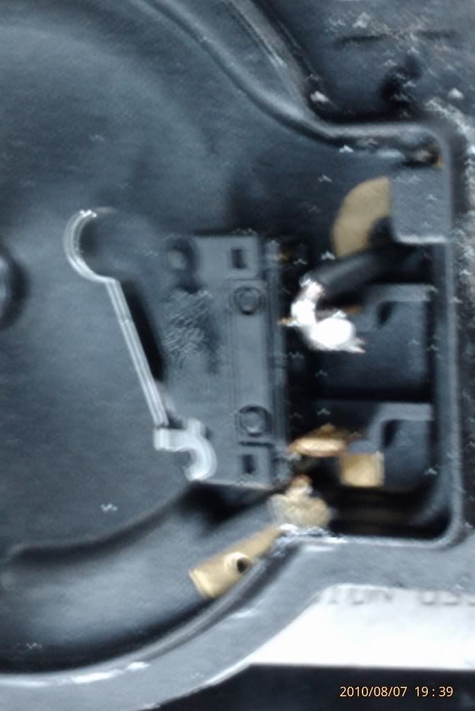

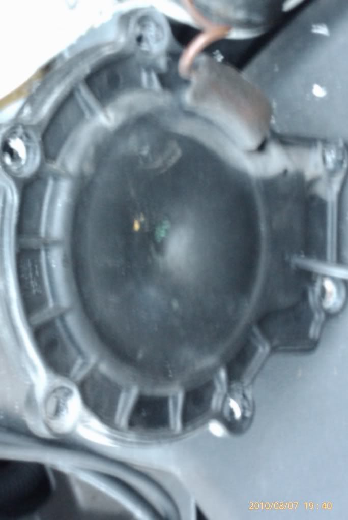

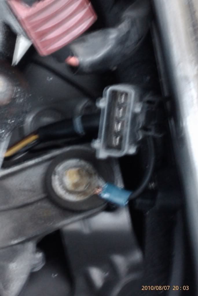

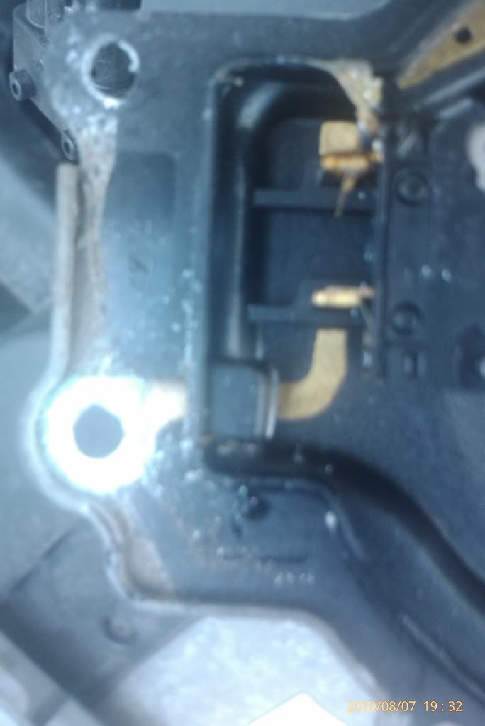

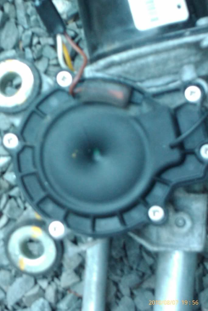

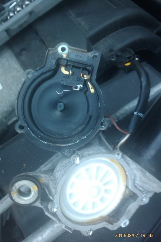

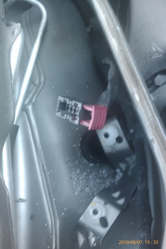

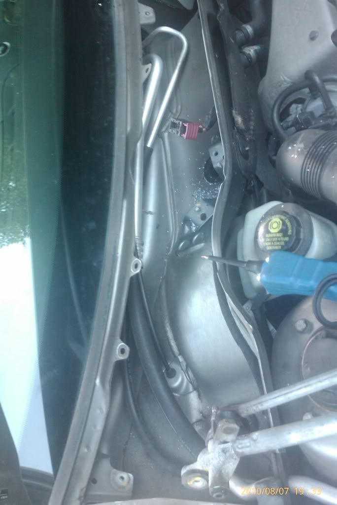

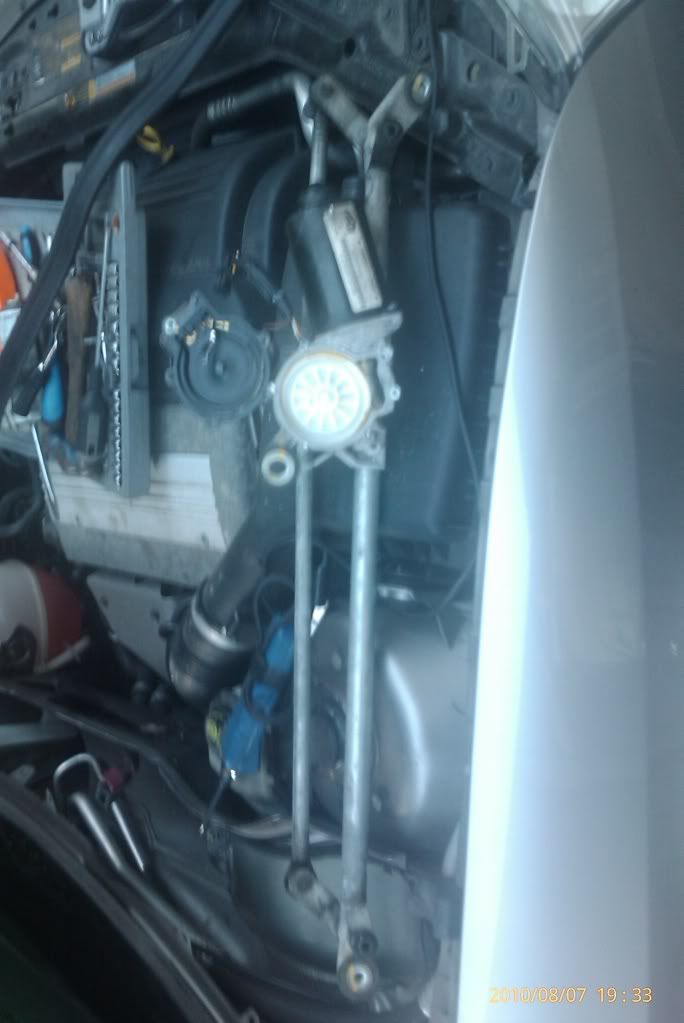

Hello all this is my first post on here, I joined the forum basically to say thanks to the people on here , my wife's 2005 93 convertible developed the exact same washer / wiper park position fault as described above and after reading your posts it allowed me to locate the fault so much quicker the fluffing around in the dark. I took some pictures of the actual defect and repair to help any one in the same position in the future. I am not sure if I can attach pics to this thread if I do not succeed perhaps someone can tell me how to and I will post the pics. ;)

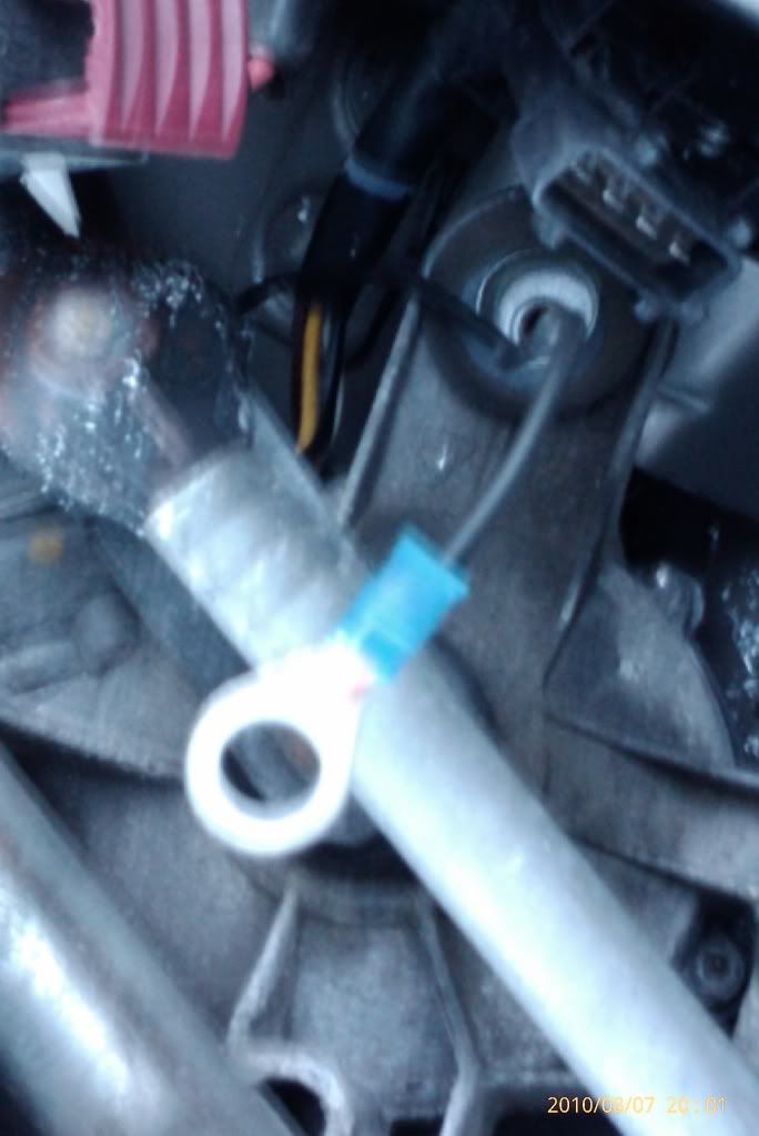

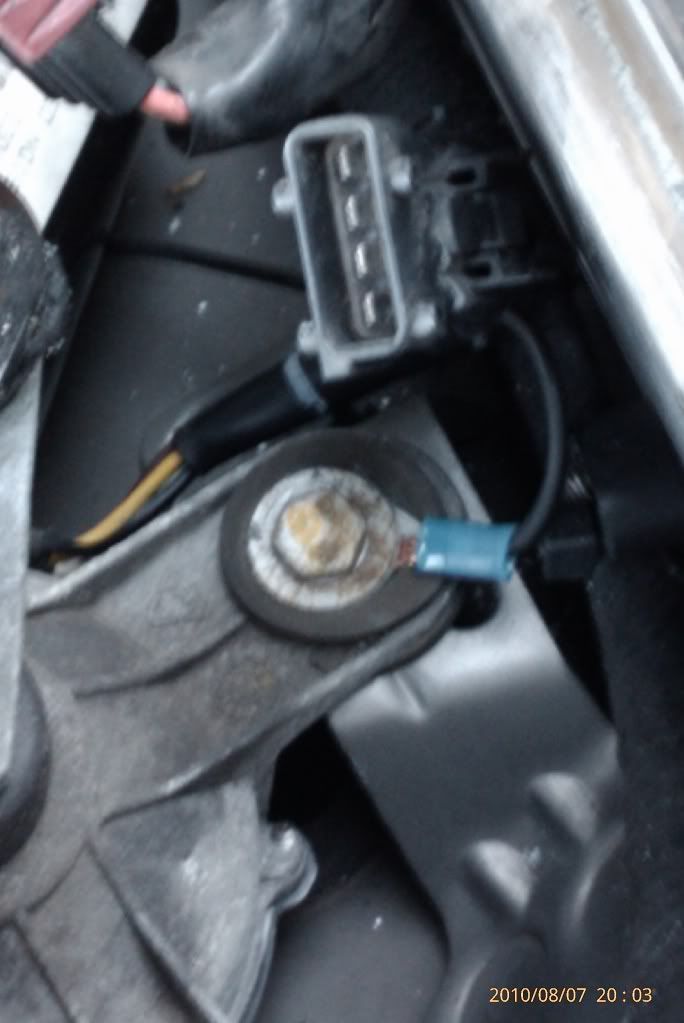

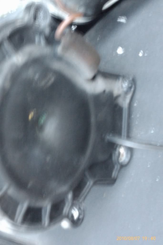

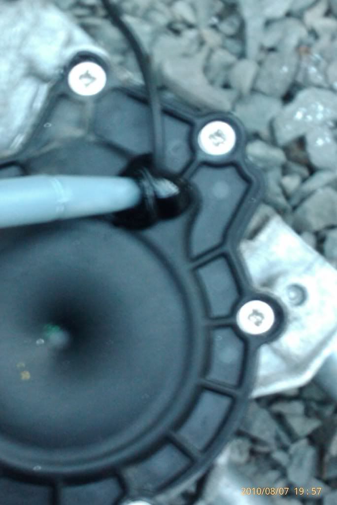

These are the rest of the pictures I took of the repair The pics are not perfect as I used my phone but you can make out the corroded copper earth lug this is the source of your problems. It would be easier to clean up the copper lug with some 800 grade emery paper at this point and reassemble, but as its a common fault lets do it right this time. I do away with the need for this earth lug and solder a black wire directly to the micro switch. this is then taken out via a hole I drill in the plastic gearbox housing which I later seal with some silicon. I terminate the 2.5 cable with a ring terminal and mount to the wiper mechanism make sure this gets a good ground not on the rubber shock absorber side. I tried to post this during the summer but was unable to , well better late than never I hope this helps someone on here.

My wiper motor was having the same issue on 2004 9-3. My wipers wouldn't park my washer jets wouldn't spray. I followed the advice of daddy2k and its all fixed perfectly so thanks for that! The brass strip had accumulated dirt over the years and eventually broke the connection. Also in the rubber molding on the outside of the cover the wire is connected to a resistor which was half corroded. I chose not to add another earth lead but cleaned and sealed the existing connection which will stop the problem returning again but either way works.
What I Did:
1- Take out the wiper motor mechanism completely
2- Drill out the rivets with a 2.5 mm drill in preparation for tapping holes M3 on reassembly and also to allow you to pop off the plastic cover.
3- I chose to use a fine grade of emery paper to get rid of the dirt and to make a decent connection on the brass strip which loops around one of the bolt holes on the inside of the cover (top left of the internal switch).
4- on the outside of the plastic case I use a sharp knife to cut out the rubber molding. check the resistor as mine was corroded. i soldered a new 75 ohm resistor to the brown wire as a replacement. and filled the channel with silicone to seal.
5- I filed flat the rivet ends on the cast body and tap each hole to M3. there are a couple of blind holes so make sure they are tapped deep enough for the screws you will install and make sure you cover the internals when filing so they are not covered in metal shards when filing. make sure the connection point for the earth is clean.
6- use methylated spirit to clean the earth connection points and then fit the cover. I used M3 x 10mm pan head screws but you can use what you feel fit its only holding a cover on so it doesn't need to be to extreme. I also thread locking glue to ensure the screws are secure and tightened down.
7- I used a small bead of silicone sealant around the cover where it connects to the cast body. This should ensure it doesn't let in any dirt ever again! for some reason the seal SAAB provide runs behind this bolt hole which is the source of this problem.
8- refit to the car and you should have your wipers and washers back to normal.
