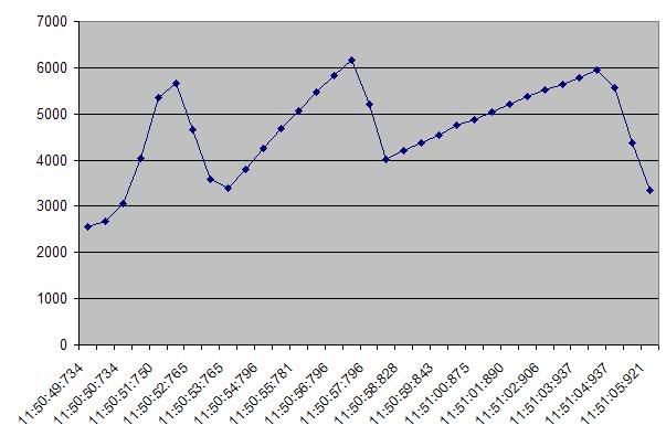

Vigge had asked me to make some 4th gear data logs. Tonight it was a chilly 43 degrees Fahrenheit, and the car was feeling quite strong. I had a good feeling about it, and that feeling was confirmed!!
I set up the logger to only record RPM and MAF flow, which sped up the sample rate to about .5 seconds between each MAF reading, and RPM reading.
Here are some peak MAF flows in the 4 data logs I made tonight:
26.89 @ 5,700 RPM in 3rd gear "Coolant Temps 1"
26.42 @ 5,500 RPM in 3rd gear "Coolant Temps 2"
26.83 @ 5,800 RPM in 4th gear "MAF Log 1"
26.69 @ 5,850 RPM in 4th gear "MAF Log 2"

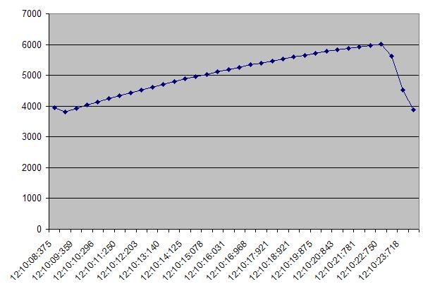

Here are the 4th gear runs (and one 1-3 gears run) with the RPM in a log below each for Vigge ... watch how long the high flow is maintained:
The longest sustained period in excess of 26 lbs/min was 3.656 seconds between 5,550 RPM and 5,950 RPM in the second MAF log.
The longest sustained period in excess of 25 lbs/min was 8.625 seconds between 4,900 RPM and 6,100 RPM in the first MAF log.
For reference 25 lb/min and 26 lbs/min is enough air to generate 273 and 283 hp in ideal conditions respectively. The peak of 26.89 is enough to generate 293 hp in ideal conditions.
230 hp requires about ~21.1 lbs/min of airflow. The car reaches 21 lbs/min at as low as 4,000 RPM.
