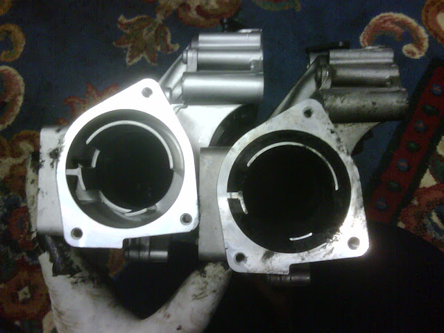

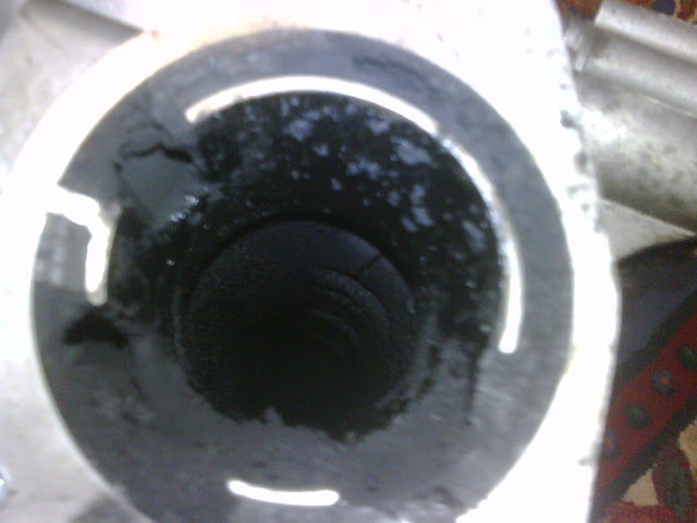

    Update: took out the EGR on Sunday morning: it was black, thick carbon deposits, really badly coked up. I suspect this is due to supermarket diesel, short runs and not being run hard enough.
    Cleaned it (slow process, separated the solenoid unit and the valve itself and soaked them in diesel then cleaned with some carb cleaner - all using a stiff brush, then used the air line to blast the last bits of soot out and dry it all out), cleaned the the pipe below it and where it goes into the head: all thick with soot.
    The connector which goes into the EGR was bodged before I took it apart: tie-wrapped in place. On reassembly, I was not convinced it was secure.
    Fired up: less noisy, smoother idle but.... engine management light on. Tried disconnecting the EGR connector: no noticeable difference (at idle, and light revving whilst stationary). Reconnected as best possible and decided it needed run: quite vigourously and for a decent duration which, if nothing else, should have regenerated the particulate filter.
    3miles in (ish) engine management light went off. It ran fine, perhaps psychological but it felt like it wasn't picking up so well below about 1900rpm but it pulled well once on boost. Over 20miles, at a decent speed, deliberately going up and down gears, varying the revs, it averaged 39.2mpg.
    Idled fine when warm. Next day, cold start (5degrees) it idled perfectly.
    Anyone any further thoughts?
    Is the connecter easy to rewire? Should I have a look at the turbo inlet? How do I check if the swirl flaps are working as they should?

    Update: took out the EGR on Sunday morning: it was black, thick carbon deposits, really badly coked up. I suspect this is due to supermarket diesel, short runs and not being run hard enough.[/b]
    No they all do it. Supermarket diesel is no different to any "branded" juice you may use. The majority of it all comes from the smae sources
    Is the connecter easy to rewire? Should I have a look at the turbo inlet? How do I check if the swirl flaps are working as they should?[/b]
    Do a search on the flaps, I mean google search, mostof the information will be on the various vauxhall sites. You really need to get the codes read to help you isolate the issue.
